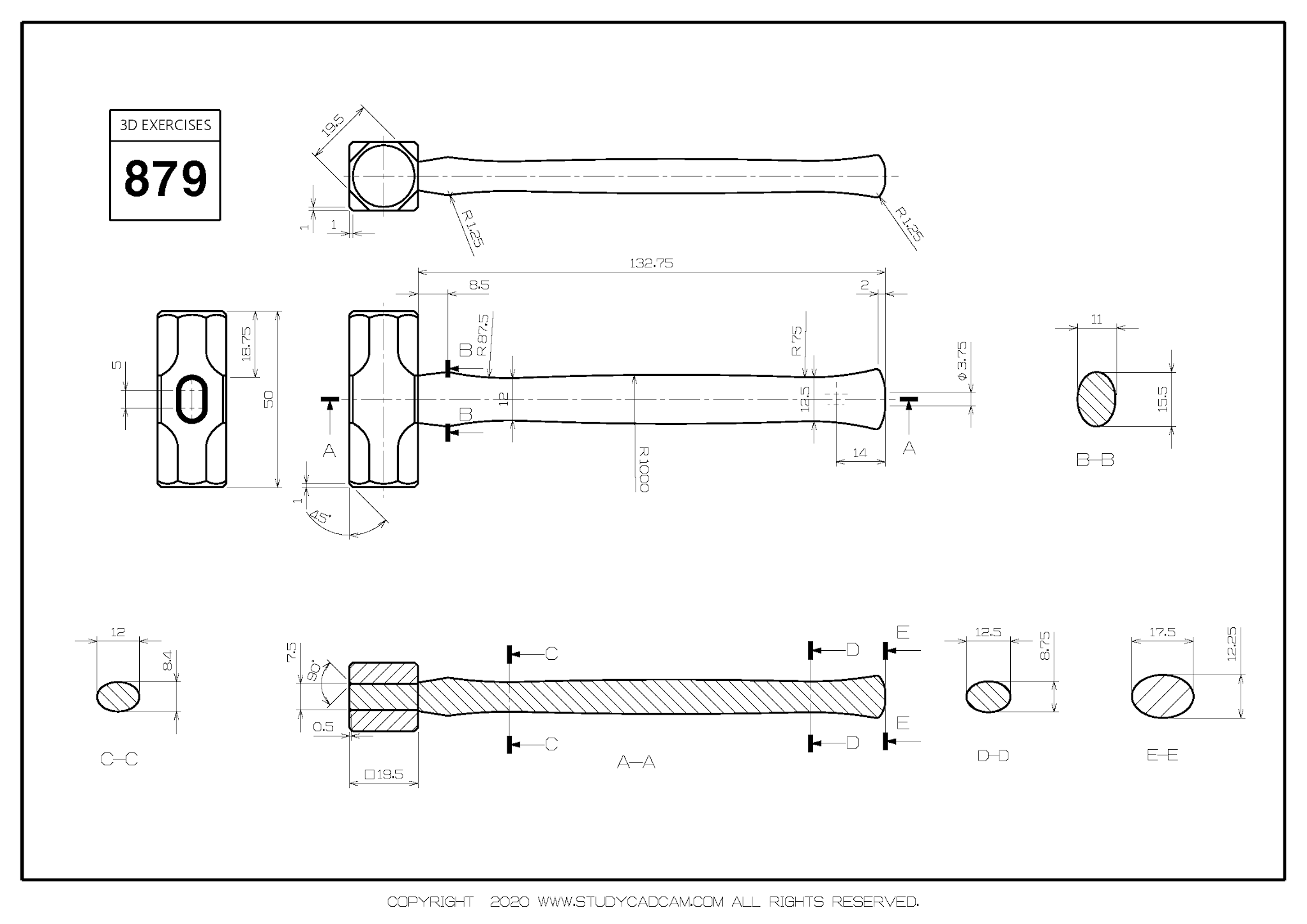

I used to Part Design WB for modelling Surface.
Sladge Hammer (Balyoz)
Reference:
https://studycadcam.blogspot.com/2020/0 ... s-879.html
